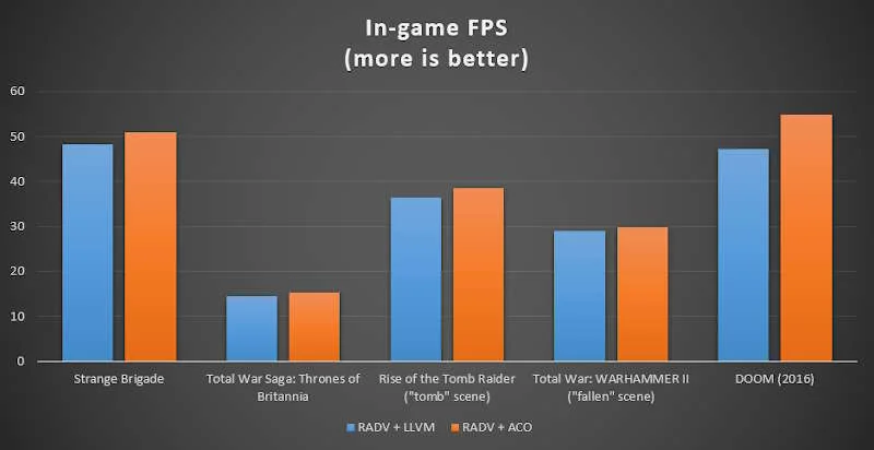

ACO - Faster Compiling (AMD Only)
aco
This is where Linus Tech Tips recently covered - Linux gaming is BETTER than windows? on June 17, 2020 https://youtu.be/6T_-HMkgxt0 and I covered last year - Mesa ACO Linux | The Future is Now! on November 20, 2019 https://youtu.be/fm_mzPBnWB0
Basically this changes the compiling from LLVM to ACO which is considerably faster. The installation process is quite a bit easier now as well compared to my video. You do need up-to-date drivers mesa 20+ and edit /etc/environment.
Add this to /etc/environment
RADV_PERFTEST=aco
