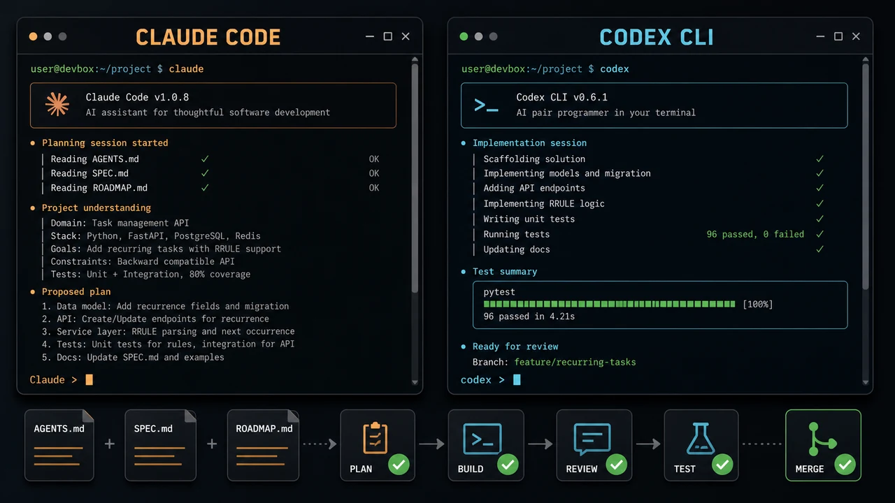

My AI development workflow is not perfect, and it will keep changing. What matters is the structure: define the project, build the guardrails, work in small phases, and stop at manual gates.
This is for larger, more complex software. You still need to understand Git, testing, and the basics of software development. One giant prompt that loops until an agent declares victory may produce a demo, but it is not how I build software I plan to maintain.
The short version looks like this:
Global instructions and reusable skills
  -> repository specification and roadmap
  -> test and validation scaffolding
  -> one small implementation phase
  -> local tests and review
  -> pull request and CI
  -> independent review
  -> fix, retest, and resolve feedback
  -> manual verification
  -> merge
AI makes each step faster. It does not get to skip any of them.
Start With Plain-Text Guardrails
I keep my shared AI development setup in the titstack repository. It contains examples for instructions, specifications, roadmaps, tasks, and reusable skills.
Do not get distracted by the terminology. These are plain-text files:
  • AGENTS.md tells the coding agent how I want it to work.
  • SPEC.md defines what the project must do.
  • ROADMAP.md breaks the work into phases with exit criteria.
  • TASKS.md can track the small jobs inside the current phase.
  • Skills capture reusable knowledge for a tool or technology.
My global instructions include preferences that apply everywhere: keep changes focused, skip filler, preserve unrelated work, run the required checks, and stop before destructive actions. A repository can add its own AGENTS.md for the real architecture, commands, and boundaries of that project.
If I dislike a rule, I delete it. If an agent repeatedly makes the same mistake, I add a more precise rule. The files serve me, not the other way around.
Skills work the same way. My Quickshell skill includes its unusual QML linting requirements, so the agent does not run a generic Qt linter, misunderstand missing types, and damage working code. A Bash skill can capture shell-specific validation. That reusable knowledge then follows me into the next project.
